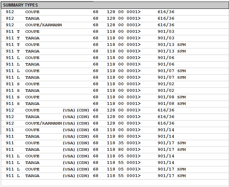

Thanks Loren! But I'm not quite sure how to read it.
Well, the chassis number starts with "118", but i thought "3" said something about engine type? 5104 is the serial number, I guess. Or does it mean (by "35") that it originally was a 911L with sportomatic (row 21 from top)? Engine: 3280692 - Possible to see if this matching the chassis?

Assuming I am reading it correctly, "The Porsche Book" by Boschen & Barth (1977) shows the 1968 (listed as starting in 1967) 911 models with 11835xxx numbers as non-US (normal) Karman-built coupes. The 3280692 engine number is shown as a US 901/14 engine.
The only 1968-model T-engines shown have numbers of the form 208xxxx. The T-chassis had serial numbers 11820xxx (Coupes), 11825xxx (K-coupes), and 11870xxx (Targas).
