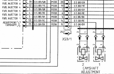

Thanks for the reply. I am new to working on Porsche cars; from what I have read: on sensor in in front and another in the the back of the motor. Where do you suggest I start looking in regards to wiring? Ive done a lot of work on bmw's but my knowledge about wiring is poor. Loren, do you have any engine and wiring digrams?

The first faults say the DME is not getting a signal from either cam position sensor.
Now you are getting a fault that says it can't change the camshaft adjustment via actuator - this would seem logical to me.
If you don't feel comfortable tracking this down you should get the car to a shop that specializes in late model Porsche's and has a PST or PIWIS tester.
