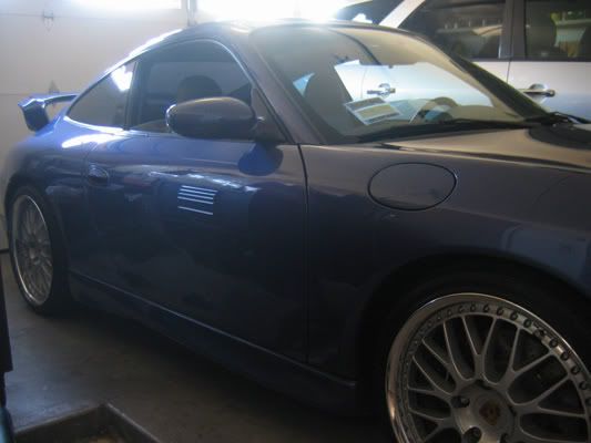

whats up fellas, after years of my dad egging me on to get a 911 (not functional enough for me), he gave up and got one for himself!
he picked up a 1999 c2 with 31k, 1 owner. absolutely pristine condition

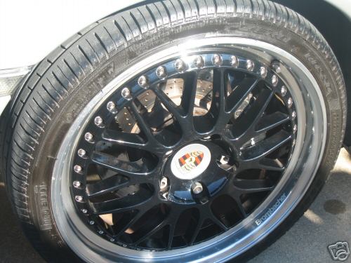

2. any idea what kind of wheels those are? they're 19s all around

2. Looks like BBS LM to me.

2. i was hoping they'd be bbs LMs, but they're not, check the rivets around the edge, bbs LMs have 1 rivet for each spoke. too many rivets on my rims.

2. Then they are a knock off of BBS. There are a number of similar wheels by Fiske, HRE and I am sure many more.
