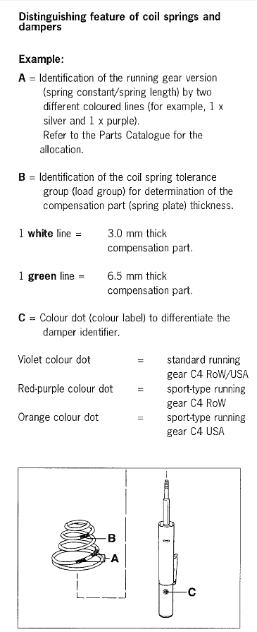

If the springs are Green/White with another Blue dot on another coil, what does this mean? Does the third dot have to match the color on the shock body?
Also, do the thicker compensation plates lift the car up by about 3 mm (difference between the two compensation plate thicknesses)? Do the compensation plates come with the kit?

The compensation plates are to adjust for differences in the body and spring height. In most cases you are best to stick with what is already there.
I will also need your transmission type to get the correct part numbers.
Thanks for the info. What if C in the diagram above is green, would I refer to your earlier post above? Also, the third dot (blue) on the springs are not listed in this thread, any idea?
So regardless of compensation plate thickness, as long as they correspond to the color, would the lowering height be the same, or will there be a difference of 3-4 mm in lowering between the different plates? When you say to stick with what is already there, do I just reuse the ones installed on the current suspension components?
