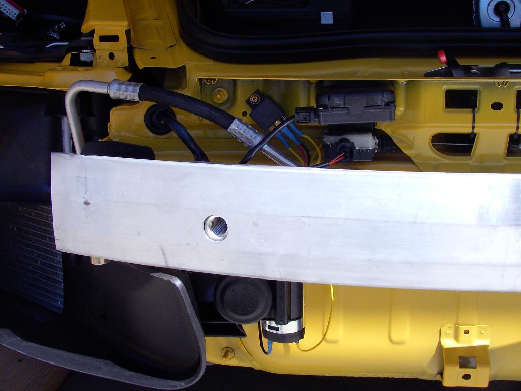

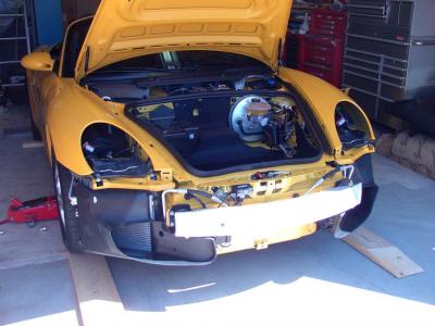

Well they are finally in, I must be a slow worker, either that or afraid to damage something because this sure took awhile!
After removing both front wheels, the front inner wheel well liners, both side markers and the front bumper cover then I could start the task of installing the air horns. There is lots of room behind the impact beam, even found a threaded location to mount the bracket for the horn.
Instead of cutting the original wires I used them to trigger a relay that supplied power directly from the battery. I know it may not have been necessary but other then the extra work of running the wires, it will make it easier to return the vehicle to stock.
They sound is great, much louder then stock, really gets their attention now... (you know them, members of the anti-destination league about to cut you off or change lanes without looking! :o )

Is that a Stobel Nautilus?

Good eye Tool Pants!, yes it is a Stobel Nautilus, and yes it is LOUD.
Good thing too, I had to warn a young lady on the way to work today that cutting across 3 lanes to cut me off wasn't appreciated... I think she heard me! :D
