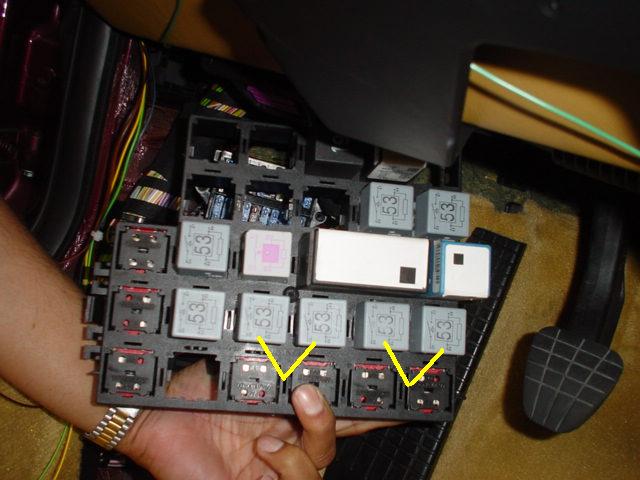

If the fuses check out then the relay tray is under the dash above the steering wheel. Picture shows the 4 relays. All 4 are the same so you can swap them around.
Yippee!!!!!!!!!!!, it was the fuse, couldn't wait till tomorrow, just been out with a torch. Suspect when rad replaced someone blew a fuse and previous owner never noticed. Can I assume they will work as cooling fans when it gets hot with A/C off?
Many thanks Loren and Toolpants.
That is a safe assumption. If both fans come on to cool the condensors after the fuse replacement when a/c is selected, then they should also come on to cool the engine radiators when the engine is hot and the a/c is off..
