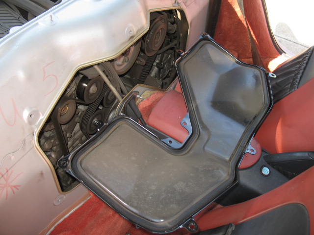

After I drove it back to my home about 10 kms, the temperature was went over to 190. I open the coolant
cover in rear trunk, the coolant was push out to every where......

Never - ever open a coolant cap unless the engine is cold. You are lucky you were not burned. It says this in your Owner's Manual.
