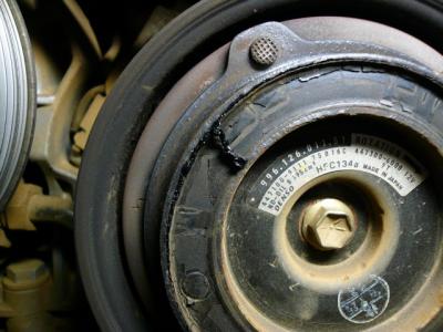

Also, the A/C compressor pulley/clutch seems to be oozing grease:
Any chance I just need a new compressor pulley/clutch assembly? Any chance they sell Porsche A/C pulley/clutch assemblies?
As mentioned in my earlier post, ( let ) find out why the clutch is damaged.
