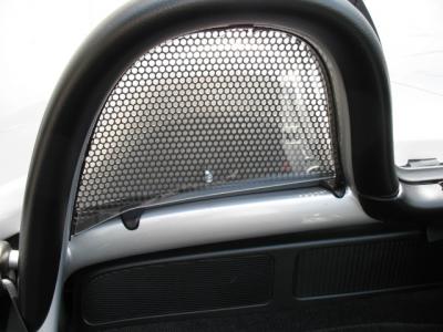

Well, I built my own. They're not as thick as the factory ones, but they do match my grills. I may be able to attach the Lexan covers to these.
Here are some pics:
I used wire mesh from Lowe's. I drew the shape based on the inside of the leather cover. As you can see, I used the 3 screws as mounting points for the mesh:
Almost finished product:
Driver side (front view):
Passenger side (front view):

pretty nice! azzoro . It would look better if they were black?
Yea, I am going to re-do them using fiberglass mesh instead. The holes are smaller and the color is charcoal. I found a nice mesh on the net with hexagonal holes, much like the OEM wind stop, but I will give this one a try first.

I didn't like the industrial look of the mesh I used for the grills so I re-made the windscreens.
These are truly a work of art (I think :P ) and better than the originals because the holes are much smaller and it reduces the air flow. They also cover the bottom more, to further reduce air traffic.
Driver's side - front view:
Passenger's side - front view:
