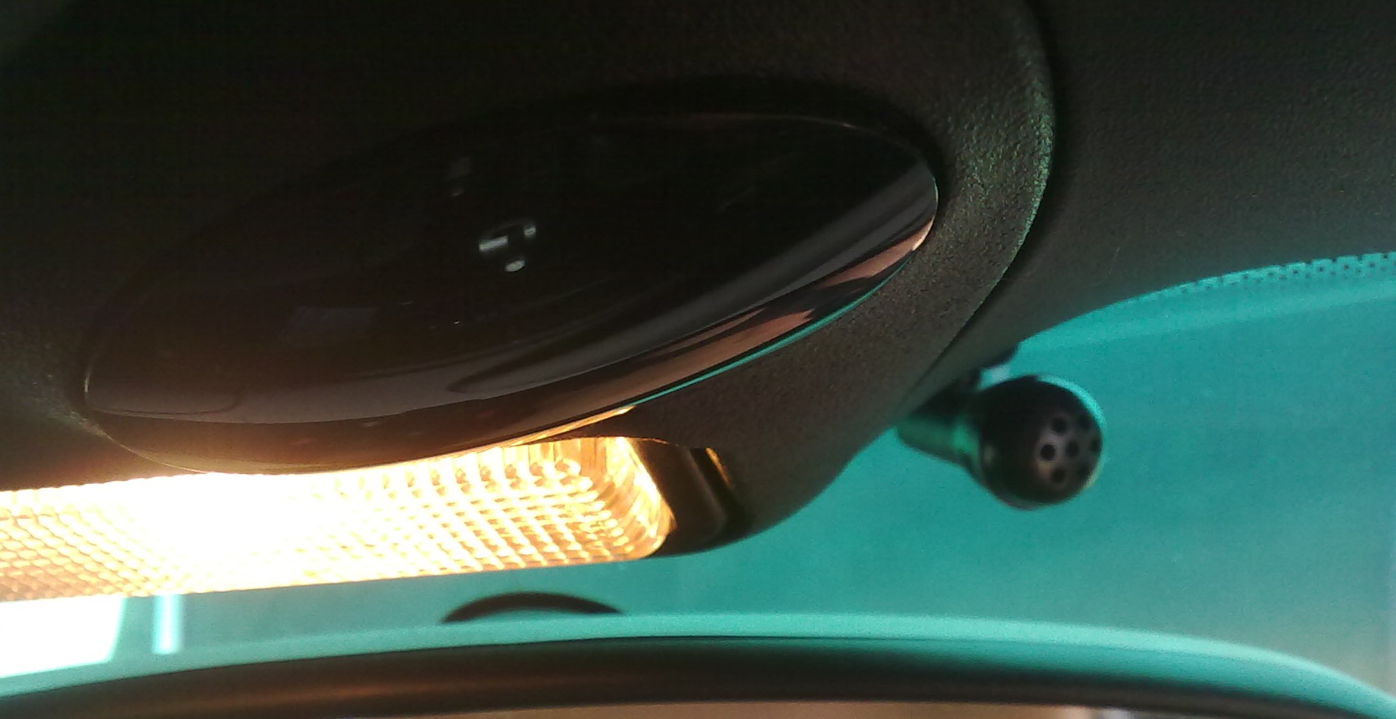

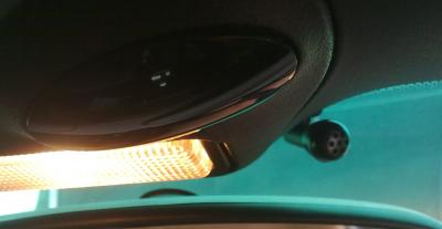

I got my installer put mine (the phone microphone) up near the rear view mirror so it was protected from the wind, there is a gap for the wire to pass out from hidden under the plastic. I drive alot with the roof down and don't have problems with calls on the road, its a parrot system that I had added when I removed the Motorola "thing" that was factory fitted.

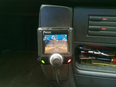

Would be great to get rid of the black bit that is attached to the LHS where the parrot is currently placed when I put in a new 2 din touch screen.
I have also ordered other bits such as buttons to fill in the 3 black one on either side of my new screen.
Has anyone worked out if any of the new model touch screens with hard drives can be wired up to 1 or 2 of those blank rocker type buttons either side of the radio like the soft top up/down one ?
