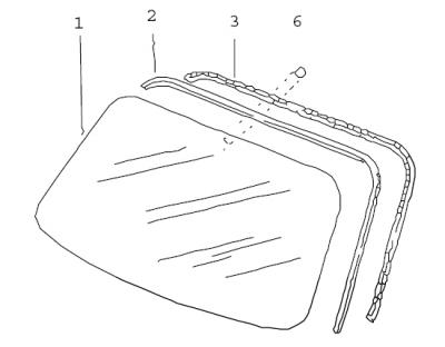

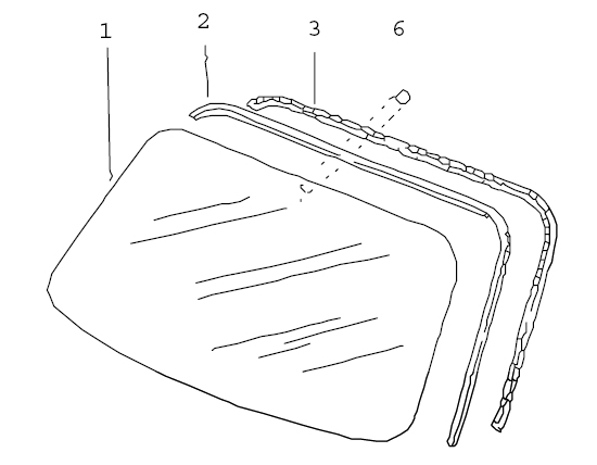

Can you remove and replace the seal and trim around the 986/996 windshield, aka windscreen?? I mean, leave the glass alone, just replace parts 2 and 3 only (see below)? I can't tell from PET or the workshop manual if you can do this; the instructions are obviously for removal of the glass itself, with the removal and installation of the seal and trim as incidental steps.
I am hoping our glass experts (you know who you are) can shed some light. Thanks, --Brian
Apparently, 3.2L Boxsters have a unique "titanium metallic" trim (986.541.541.02.9A4 for 2001-on) around the windscreen. Mine looks terrible from some sort of corrosion/deterioration. The parts are relatively inexpensive, so if I can remove/replace without having to alter the state of the glass, it would allow me to direct my OCD elsewhere.
From what I can tell, it seems as if the metal trim is slotted for the glass to fit into around its periphery. Does the rubber seal snap into the trim behind it? Thanks, Jeff.
--Brian

Answering my own question here.
It turns out that you can rather easily remove and replace the EPDM rubber seal (996.541.531.01) around the windscreen without disturbing the glass or the metal/plastic trim that it presses into.
The metal/plastic trim, however is not likely to be removed without significant effort, unless you are taking the glass out, too. The trim is more than decorative, it acts as a spacer between the body and the glass and has glazing oozed into it in various areas, particularly the upper corners. With the windscreen in place, my advice is not to attempt to remove the trim from the glass unless it is evident that it can be easily loosened from 100% of its periphery.
--Brian

I am going to attempt this on my 2001 986 - the rubber trim (996.541.531.01) is badly sun damaged.
Please write down how the rubber trim replacement went. I haven't exactly the same issue on my 2002 986 - S
Wish you good luck.
Sent from my N9518 using Tapatalk
Looking at what seal I was sent, I realize my problem is with the metal/rubber seal that is around the perimeter of the glass - not the seal between the body and the windshield.  I'll post a picture later, but it appears there are two seals stacked here, and one of them is attached to the glass directly.
