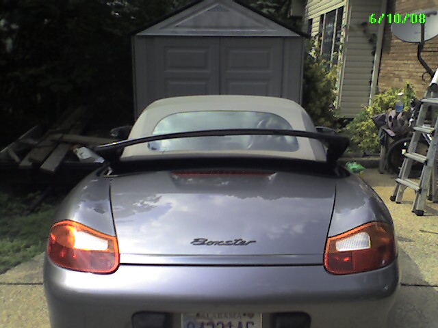

I am in the process of building a house and had a rather rigid plastic tube containing house plans stored on the small storage shelf behind the seats. This tube had been kept there for several weeks without problem until today. This morning I lowered the top and as the process was nearing completion there was a hesitation in the completion of the process. There was no unusual sounds, just a slightly longer opening process. Later, in anticipation of rain, I closed the top without issue except that the light indicating fully closed had not gone off. I then reopened the top slightly, about 1/4 open, and attempted to reclose, nothing happened. The clam shell was partially open, the top was still 1/4 open and nothing would move. I got out to look and noticed that the clam shell was canted slightly, lower on the left. I could hear a clicking when I depressed the switch but no movement. I was able to push the top down enough to latch and drive home.
Now, here I am. I hope that someone can lend assistance. This is the first problem that I've had with the car, I absolutely love it. I am fairly handy with tools so I am hoping that this is something that I can handle myself.

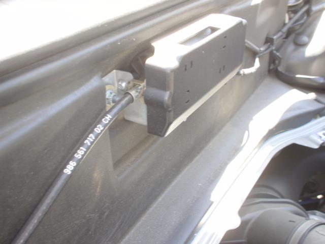

Under the clamshell is a motor with 2 cables connected to it. Left cable and right cable. Disconnect the cables from the motor. First picture is from a car like yours. You will see a brass clip that holds each cable to the motor. Lift up on the clip to remove the clip and pull the cable out.
Inside the black housing of the cable is is the inner drive cable. The drive cable is spun by the motor to make the top work. The drive cable had a square end. Second picture is my 1997 and your motor will not have the lever on top.
Pull on the square end and see if the drive cable has broken inside the black housing. In the 3rd picture you can see a section of the drive cable has broken off from the rest. This also shows the square end on the left of the picture that goes into the motor.
