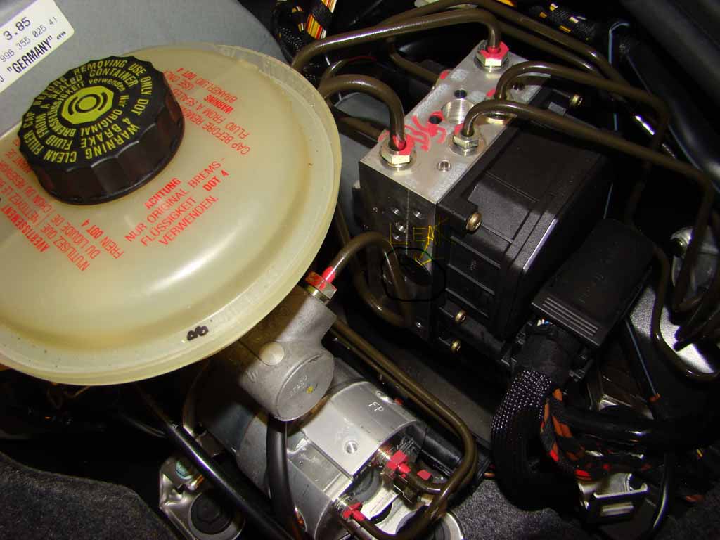

I have a 2000 Carrera 4 Cab with only 8000 miles on it. I drove it around for about an hour realized the brake pedal feel was very soft and stopping power was reduced substantially. Sure enough the brake fluid light turned on. So I stopped at my local auto store and sure enough the brake fluid level was very low. I filled up the fluid and the light turned off. Once I put in the fluid the brakes were better but nowhere near 100% after another hour or so of driving the light turned back on again so i figured there was some sort of leak.
Long story short, When i push the brake in there is an air sucking sound around the fluid reservoir found under the front bonnet. After this sucking sound there is a leak of about an half ounce of brake fluid from a box where there lines connect. Can someone fill me on what this may be and if it is in fact an easy repair or maybe even a DIY. I have attached a photo of the box that is leaking.
It is the ABS hydraulic unit, if the fluid comes out on the body part and not the lines connectors, a replacement is needed. It is dangerous to drive with, keep the fluid level always on top and drive to the dealer or better use a flat bed trailer.
Thank you very much for the quick response....I will take to the dealer as soon as possible

OK so I spoke with my dealer and apparantly the repair will cost $3000 USD to fix, it seems like it would be such an easy fix if I could just understand how this unit works. What would be a catalyst that would cause the ABS hydraulic unit to be over-pressurized and leka fluid out of this tiny little hole. It seems like there is not enough pressure going to the brakes, any help would be greatly appreciated. Thanks
That ABS block is about $1700 US MSRP - so that is about half the cost.
The design changed so there will need to be some other parts replaced too. Lines and some fittings as I recall.
You try to convince the dealer that a problem like this should not happen after only 8000 miles regardless of the car's age.
Maybe he will give you the parts at his cost - if you pay the labor?
Replacement is the only repair. If the dealer won't offer and help because of the low milage, search for a used part and get it fitted by an independent garage.
