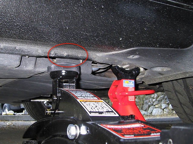

I know that there have been plenty of threads on jacking, and I have looked at all of them but I am having a few problems. I am trying to remove my wheels so I can clean them thoroughly, and coat them with some wheel wax.
I started to jack the car up at the alt. jack point a few inches forward of the official rear point. Using these instructions: http://boxsters.addr.com/jacking.htm
I got it up and then lowered it check everything. The crease that you are supposed to use was starting to buckle and bend, luckily I caught it before it got too bad.
So what am I doing wrong?

I circled the part that is bending:
Edited by rick3000
I am sure that the bending isn't damaging anything important, but if I can jack the car with out hurting anything I would prefer too.
When I started to jack it up ignoring the buckling I heard a loud creaking sound. I immediately lowered the car to discover some bending, that was a little worse than I am comfortable with. Perhaps, the hockey puck I just bought will help.

I can't get the jack back far enough to use the point under the engine, so I am going to end up using the side alt. jack points. It seems like plenty have used it without problems. Plus, I think the hockey puck will work nicely as a cushion, know that I have molded it properly.
Jes, thanks for that post. So what you doing is using the factory point, and then putting the jacks on the points labeled PCA B in the picture on the other thread? That's seems like a good way to do it.
So when I was feeling under the lip where this alt. point is, it struck me that once the metals bends, and is flush with the piece underneath it, that point is strong enough to jack the car from. But you have to bend the metal the initial 1/4", which is barely noticeable even when you looking right at it.
Is this assumption correct?
