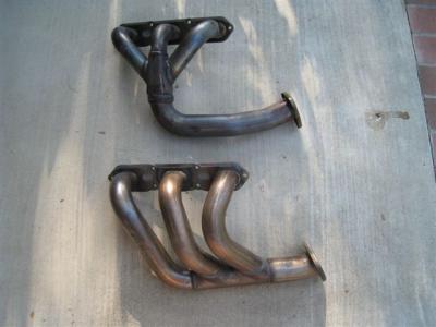

I changed mine out this past weekend too. They were quite easy on my Targa4S, although I wish I had a hoist! I had to loosen a hose clamp to get access to the rear manifold bolt on the passenger side header, and had no problems restarting the bolts. Biggest challenge was getting the new manifold gasket in position during installation of the new manifold. I've got photos that I'll send later this week. I haven't noticed any difference in the headers, but to me the X51 headers just look better (big deal eh?). I also put a PSE system on at the same time, so the main improvement is ability to add noise on demand.

Previous poster wanted photos. I've attached one showing the stock manifold and the X51 manifold.
What a fantastic photo! the difference is amazing.

Thanks for the photo and driver reports
