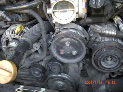

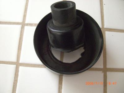

It did not brake the alternator mount. Half of the pulley from inside got carved out like somebody used a can opener.

Depends on the pulley that broke and whether it boke the alternator mount.
If you hear a squeling noise for a few seconds when you start up your car, don't always assume its the belt. In my case it was a worn out bearing on a pulley. Normally when they fail, they will brake the alternator wall or the engine wall since they are bolted in them. I was driving very slow because I was making a turn, so the damage was minimal.
I didn't want to take any chances of that happening again, so I replaced all three pulleys.

Heres some pics of the warped out pulley. I was lucky that it did not brake anything else.
