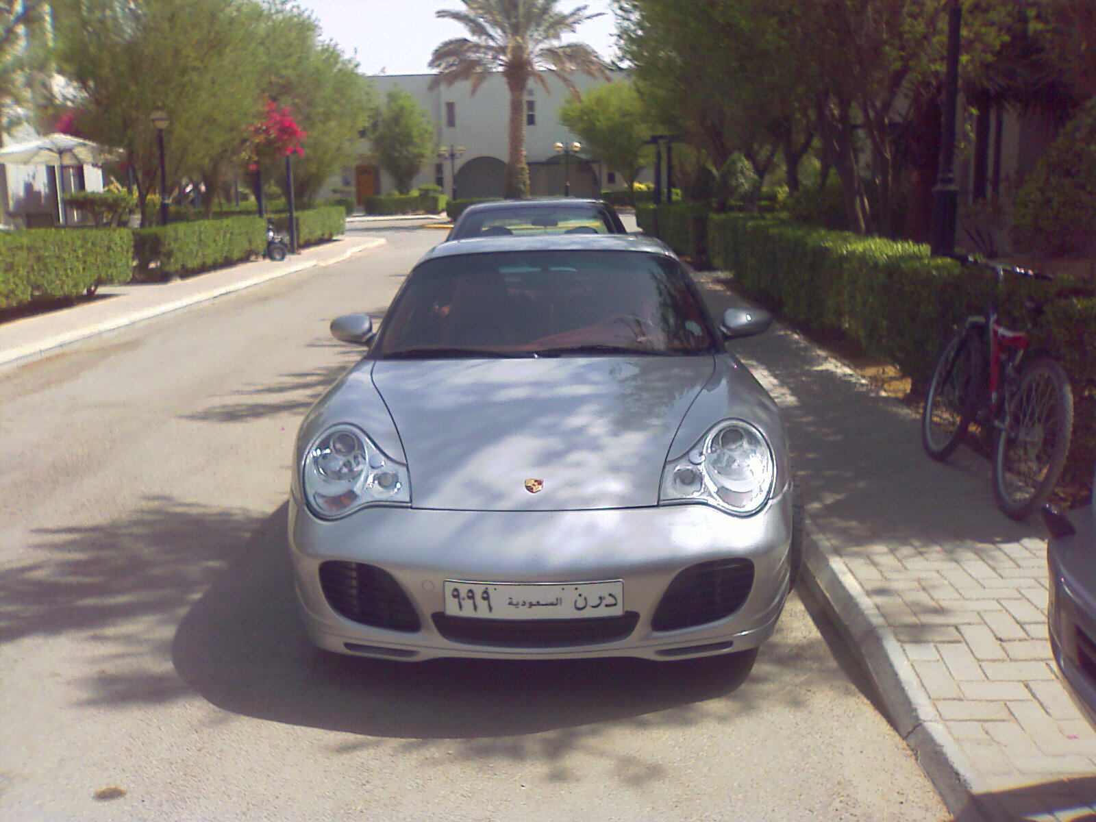

Hi from Saudi Arabia! I have a 2004 996 4s and it is a joy to drive. It is my daily car and drive around in temperatures of 47c. I have taken this car to Bahrain and back averaging 200kph there and back. This is a strong car! But the only issue I get is that the PCM comes up with a message saying that its shutting down due to overheating in 10 seconds. I took the car to porsche and they said everything is fine !
Does anyone know how to get around the issue?
