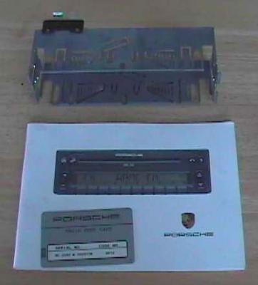

Our local group has remove many 220 radios on Boxsters to hook up rear speakers and/or cd changers, so I know what the 220 housing looks like. It has been 5 years since I removed my 210 to hook up a cd changer and I do not remember what the housing looks like. But here is a 210 housing I saw on ebay.
Horst on the Becker board use to say you needed to remove the entire 210 housing so the 220 would slide in. But you folks are talking about just removing a thin piece of something.
Anyone have a picture of what needs to be removed for a 220 to fit in a 210, as I have a feeling that is what I may need to do for the TrafficPro to fit in my 210 car. No mention of the housing in the Porsche Boxster TrafficPro instructions, which covers 1997-2002, so I may have a concern that does not exist.
Tool pants. The looks similar to the part in your picture, although it has been a few months since I have handled the piece so my memory has faded. Unless it is the owners intention to reinstall the 210 unit back in the car this part can be removed with some forceand may suffer damage without ruining the dash.
