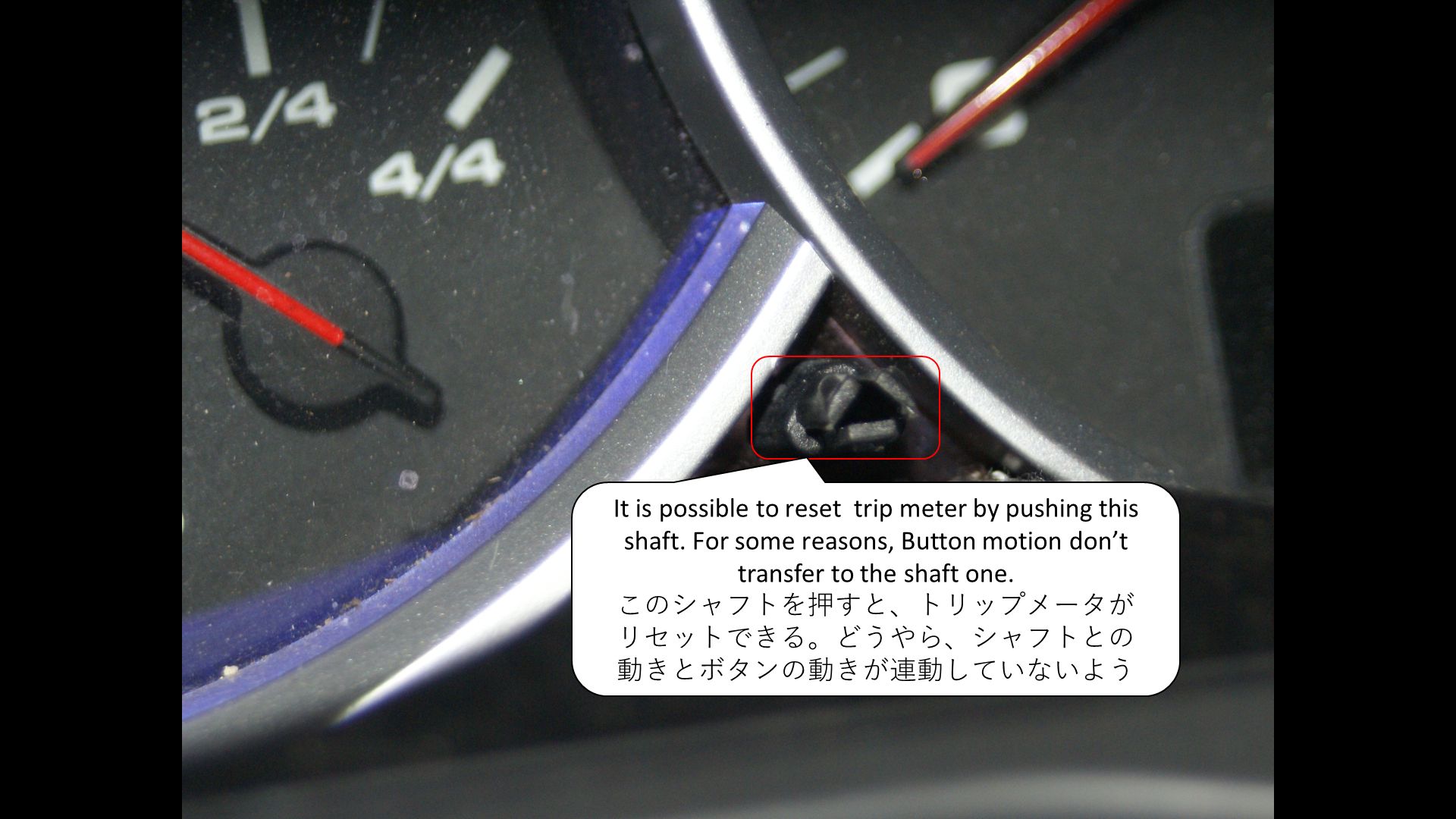

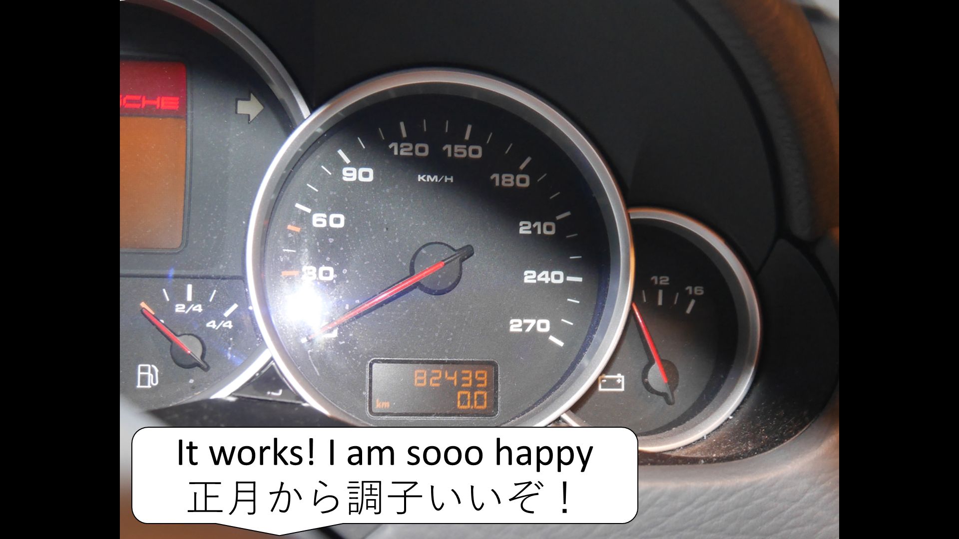

I have the identical problem. Button can't reset the trip meter. I remove the button, and SW shaft observed. It is possible to reset the trip meter by pushing the shaft. For some reasons, The button motion don't transfer to the shaft one. So I introduced tiny shaft . See attached pictures.
