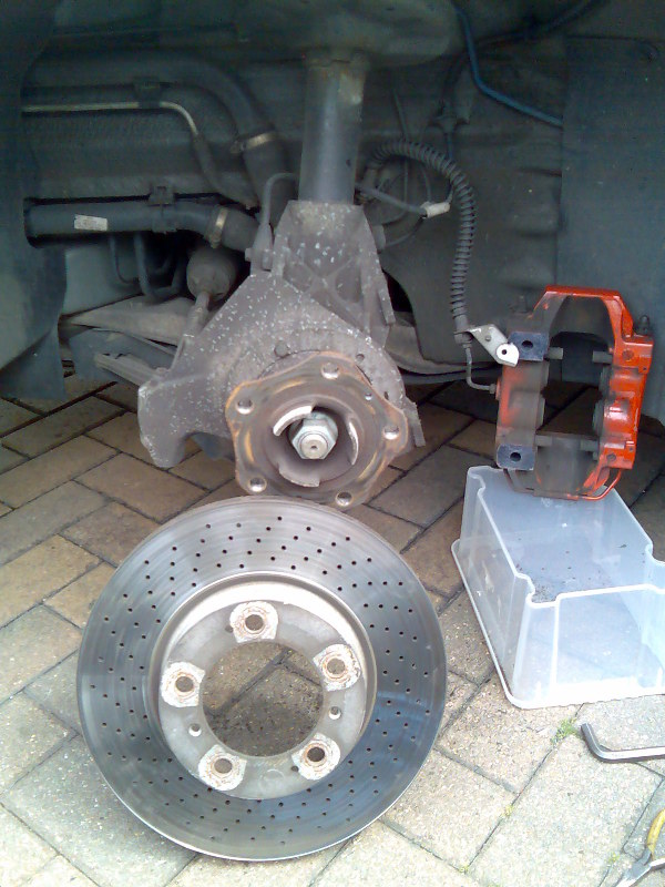

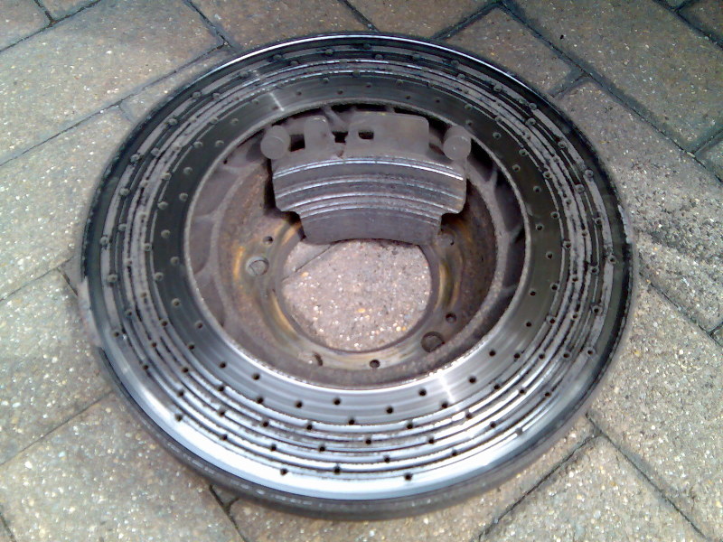

Hi All, thought you might be interested in some pics of my rear discs on my 2000 2.7 I've just replaced after 50k. I have seen posts about similar wear on front discs but rears. From outside the car you wouldn't know there was a problem, it was only when the car was up on ramps that this was spotted.
Incidentaly, replacement was a very simple job the only additional tool needed was a 10mm hex socket.
(think I've managed to upload pics! here goes anyway.)
Very uneven and cracked, despite this the pedal was good. Don't yet know much this will affect braking as I haven't had time to bed them in. This is my first Boxster and have felt that quite a bit more effort is needed on the pedal than other cars I have driven, but I read here thats normal.

Interesting, both pad surfaces should be the same, full contact. In this case there would appear to be 'something' out of alignment.

I would have expected that there would either be friction material missing to correspond to the area of the rotor that appears untouched or that the backing plate for the pad was not flat against it's mount.
As for moisture IMHO, a few minutes of brake use should eliminate all traces of moisture from the pads. I still beleive that uneven wear like that is the sign that either the system was re-assembled incorrectly, something is broken (jammed or seized, either a piston or slide) or the brake pad is defective and the material is breaking away.

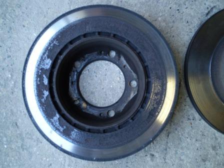

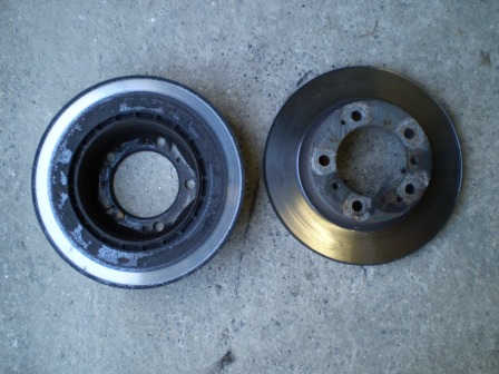

It looks like those rotors have started to rust out, and it does so from the rear of the rotor. The front of the rotor always looks fine. Only on the UK message boards have I seen pictures like that. Must be all the rain and/or the crap they put on the roads for winter.
Pictures from PGrimston on the Porsche Club Great Britain board.

Thats interesting Toolpants, same type of wear as mine.
