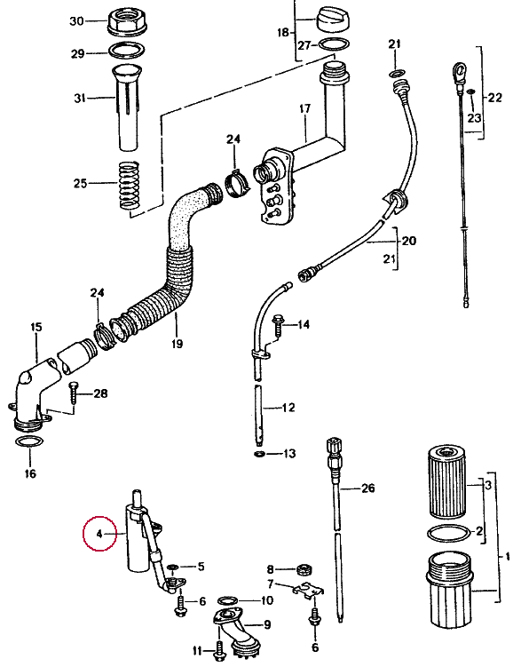

Here is how I understand the "oil separators" use.
There are actually 3 (what Porsche calls) oil separators.
Two are in the sump and are used primarily to remove the air from returned oil so that when the pump picks up sump oil to circulate through the engine it gets oil and not an oil/air mixture. These are really swirlpots that defoam the oil. These are usually pretty reliable and rarely fail. (see item 4 below)
The Air Oil Separator on the top of the engine is the common one to fail. It is used to take oil droplets (mist) and vapors (gases) from the crankcase and return the oil to the crankcase and burn the oil vapor in the engine (for emissions control). Most often the membrane in this oil separator fails and you get huge amount of oil sucked into the intake (and produce clouds of smoke). (see item 1 below)
Do you have the part number for the aos that is on the top of the engine ?
ps.Thank you , thank you , thank you for your help
996.107.026.51 oil separator -- US MSRP $97.19
