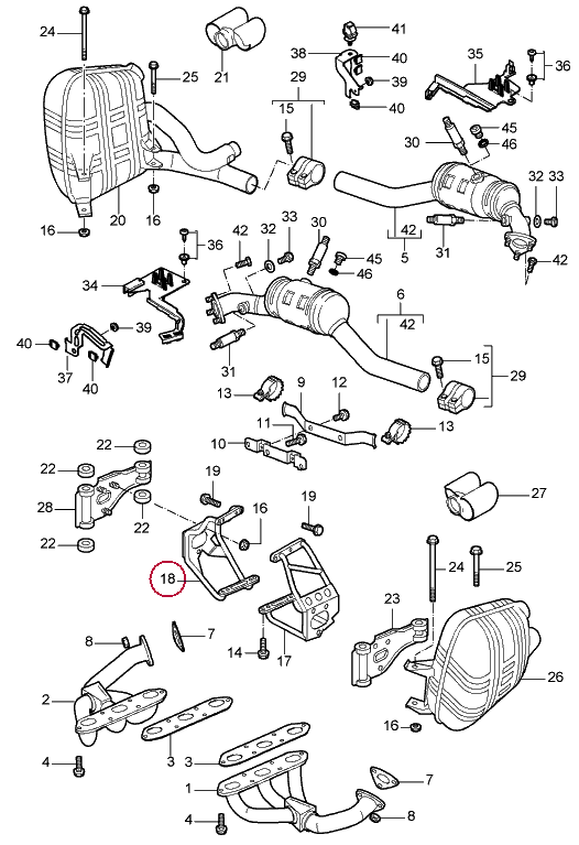

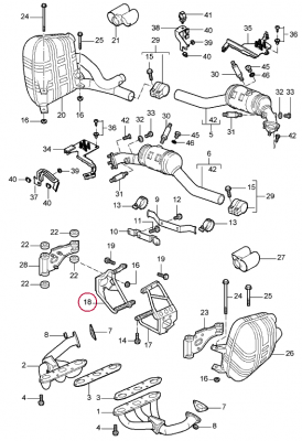

I did not take the mufflers off. The metal that is in the way comes down from the
top of the motor and runs to a bracket near the part where the headers
bolt on to. My guess is this metal is a motor support bracket.
Removing the mufflers would not help to get to this capacitor coil
bolt. The bolt is the fartest rear bolt on the passenger side. I will
buy a socket spinner and also wrench the torq socket.
Paul
That is the part. Part 18 lines up with the rear spark
plug on the passenger side. Part 17 lines up with
the middle spark plug on the driver's side. These parts are
so close to the capicitor coils that it makes it hard to get your hands
up in the space to work.
