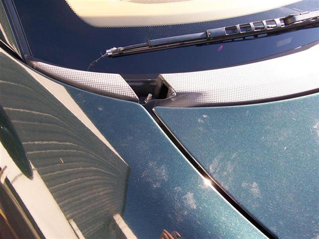

I need a part number (and a correct name, if possible) for this missing little plastic cover:

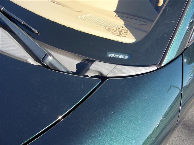

There's a nut and stud fastener underneath, and there's a matching cover at the other end:

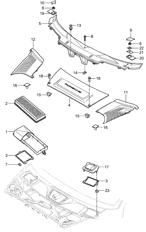

Do you just need item 10? attachicon.gifcowl.png If so, it is 997.572.570.04.FMT cap, black -- US MSRP $1.87
I will be collecting this cowl part from my local porshe dismantler. I did have a question though. Isn't there a difference in the cowl part? my understanding is that some cowls are for the cars with antenna and navigation and some cowls are for non navigation cars. There is a metal underplate for the antenna on some cowls. Anyone know anything about this?

Not true - there is one part number for for all 997-1 models regardless of options.
All the NAV antennas sit below the cowl piece.
