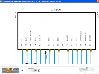

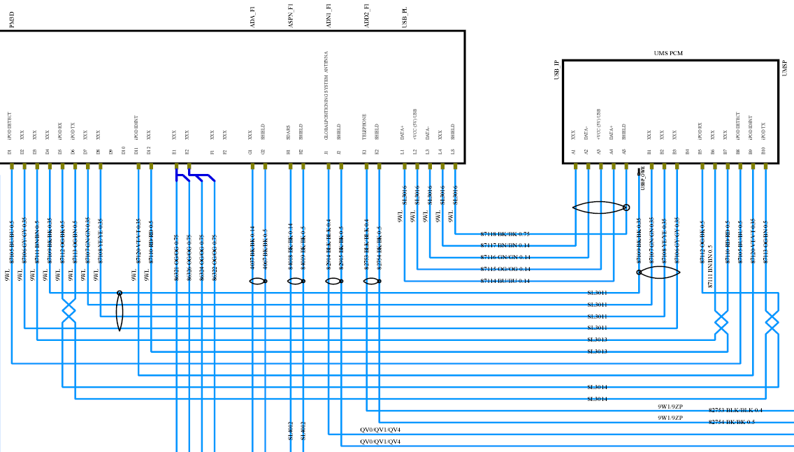

Question - does anybody have wiring diagram for PCM3 (2009) connectors (main square connector where all fiber and copper wires go) by part numbers i am looking for wiring diagram of cable 955.647.219.25 (bluetooth) , 997.044.902.43 (Ipod?) ?
P.S. things i have learned PCM3 Navigation disks form different region would not update. I now have spare European map Database for Europe for PCM3
Loren, is there any way to receive the entire picture of a bigger diagram that i can see in lower righthand corner of that picture? Is this software available to to simple human or is a dealer only?
This is from inside PIWIS - so all I can do get a screen shot. So I can only "blow-up" small sections and still have them readable.
What exactly do you need?
you gave me picture on the ipod end , i was trying to see how these wires (from previous picture) connect to PCM connector. i cannot see well but my guess is that it is the area to the left of previous picture where other end of these wires connect to PCM
Here are the connections from the iPod back to PCM3.
I hope it is readable.
