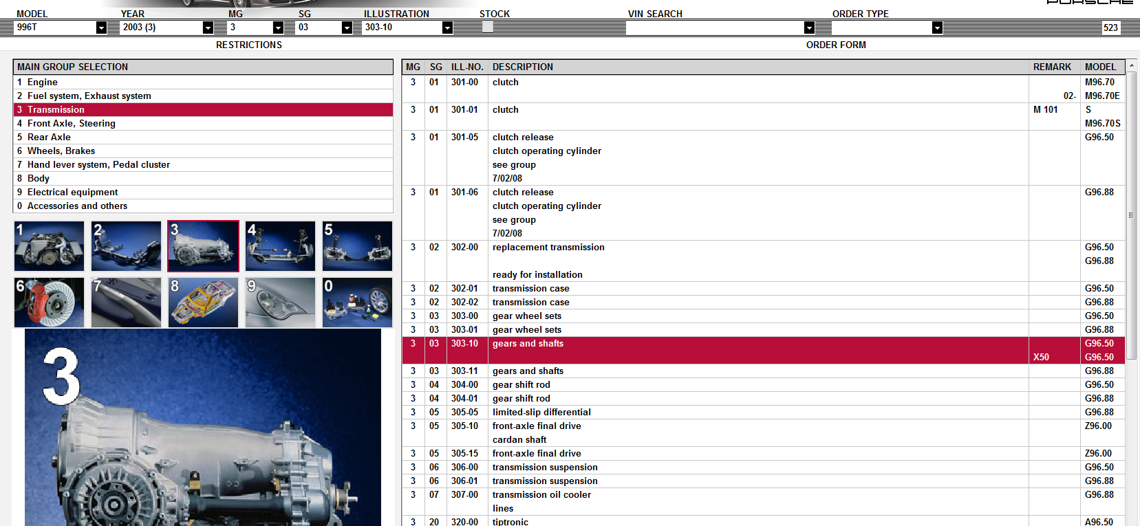

Is it true then? This seems to be something that noone has clarified 100%: some say the GT2 transmission is exactly the same, despite a different part #, some say it's supposed to be more solid (though this sounds... improbable)... some say the gear ratios are different (but why would they be? The difference isn't that significant).

So why does Porsche stock two sets of part numbers and gear sets?
