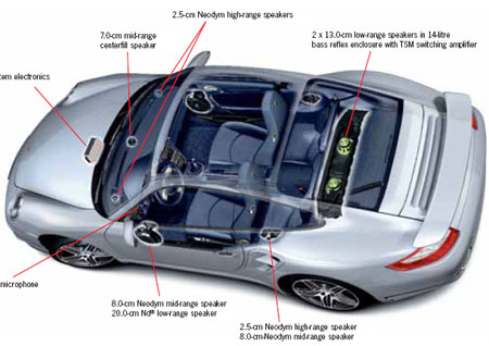

Does anyone have any ideas on where it is? It's not in the front compartment like the drawing above.

the Bose amplifier is located downside the passenger seat on the 09 carrera
but becarfully to install an other audioequipement because all electronic system in the new carrare is coded to work together

Look behind tools. See owners manual for location tools in front trunk.
With PCM3.0 and 2010 cars, Porsche took the decision to eliminate the trunk mounted amp in favour of an item mounted behind the PCM3.0 module - hence the empty space behind the tools. IMO this new "amp" is inferior to the old unit that used to be supplied with the sound package plus option (non Bose).
