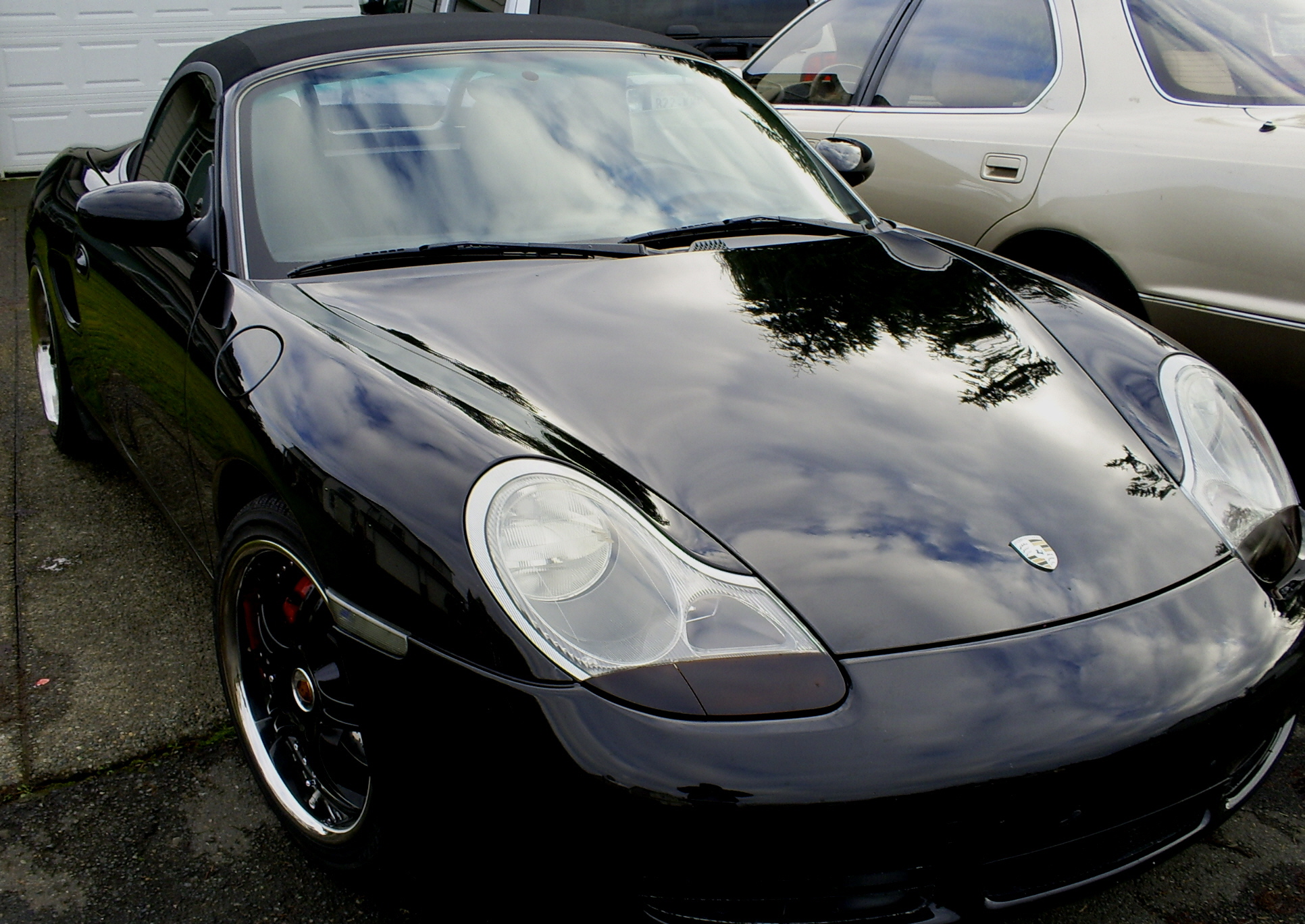

ps here are the pictures of my car with the oversized tires on them lol
Edited by msediqi
msediqi are U satisfied with the look???,,,
just my thought, I think U should sell the whole package & get something prettier.
let me know how much credit U gonna get from D/C tire, might be interested in those.
The one thing i love about these wheels is the black finish, i think thats an amazing touch, are you interested in the tires or the whole package ? My appointment is D/C tire is tomorrow at 10am so i will let you know, and the credit is only for the tires because im just trying to lower the tire size, if i can trade these for some different porsche rims that will look better on my car im willing to trade if you have anything to offer or just sell them to u. Were you interested in just the tires or both the tires and the rims?
Man those are sweeeet! are those the ones on your car or different ones ? the tires ill let you know how much they give me credit for, pm your number so i can call you right away and let you know if you are interested in matching what they offer or if your not interested so i can get new tires right their and then, my name is Roin by the way.
