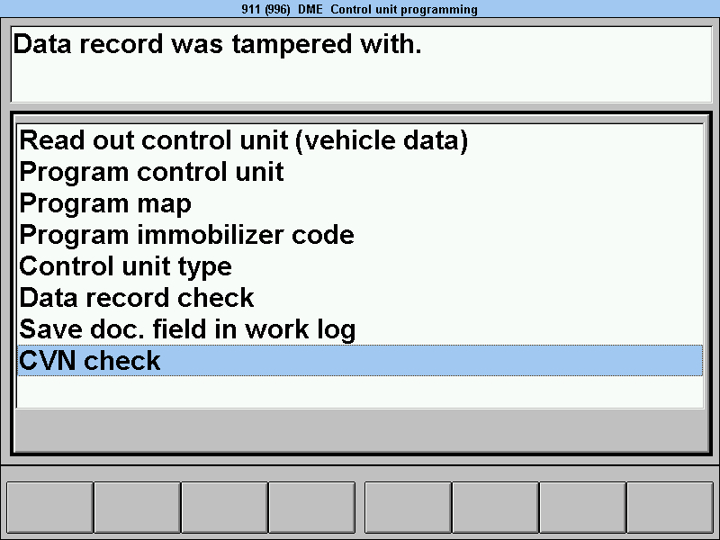

The quote about "total neutral at inspections" is untrue. All Porsche DME's since MY2002 have had technology added that can detect an altered DME program.
Upsolute uses a "piggyback chip". Even if the dealers PST or PIWIS does not see - it is physically on the DME (in plain site).
