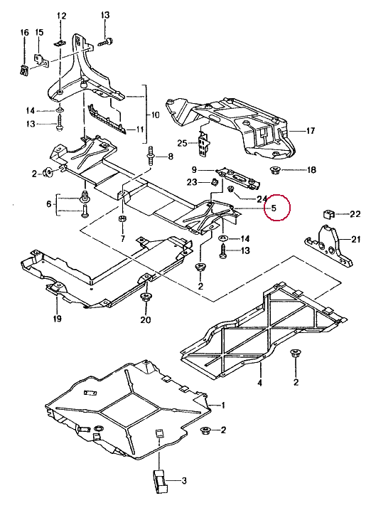

I need to replace a panel on the underside of my '04 Boxster 2.7. Before I order, I wanted to make double sure by running
it past you guys. I found this panel and want to make sure its for my specific model. It looks like it but I haven't had the car on
a lift yet. This is the part number I have for it, 985.504.119.00
Thanks for reading, and any input is greatly appreciated.

I purchased the panel from my local Porsche dealer for $104.53. Sunset had it about $20.00 less, however, they need to ship in a larger box and I did not need filters or anything else to make it worthwhile from a shipping perspective. This is the second panel I've replaced over the years do to road debris. Quick replacement...same panel you have to remove when changing manual transmission fluid. Rolled my car up on ramps from the rear tires and took about fifteen minutes. Need a torque bit and a 10mm socket. Broke my old one in two pieces and it's in the trash for tomorrow's pick up.
All the best,
Bill B)
I just checked my receipt...the part number I ordered was 986-504-119-00 (List $116.14 / $104.53 with my PCA discount). You may give Sunset a call if you can fill the box with an air filter, cabin filter, and oil filter; may be worthwhile. I like my local Porsche dealer, but those guys at Sunset are terrific to work with too! Great prices.
