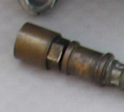

Actually for the clutch slave, it is a steel circlip that holds the brass male barb with a concave groove. The servo has a convex bulge and the plastic release collars for the return lines.
The slave hose is different for sure, and it looks like you just pull it hard apart and replace the circlip if needed. Just don't want to go medieval on it until I know the facts for sure.

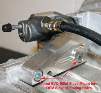

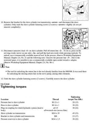

Changing over to the EVOMS accumulator delete, and I need to change the clutch slave hose. It disconnects here...
Does it just pull out? By the looks of the replacement, you just give it a tug. Correct?

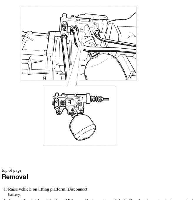

And this fitting it exactly were you disconnect the hose that goes to the slave and you have to used two open end wrench 15 mm.
Edited by jpflip
There has to be a way to disconnect the fitting from the hose (stupid to say from me). Circlip of some kind because the base of the new fitting looks exactly like the base of the old one. Keeps us inform of your findings. That is not something we have to dismantle when we replaced the slave....

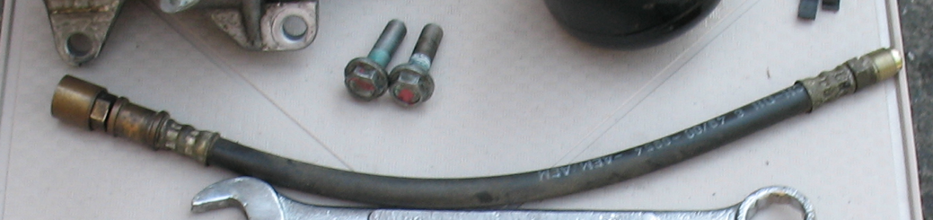

I don't understand... You don't have the hose already out of the car on your workbench?
No, waiting for a replacement fitting for my Motive Bleeder before I shred it. Just doing my homework...
