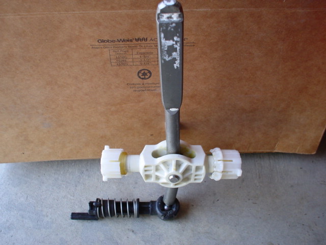

This is the oem shift lever which has been removed from the shift tower for a B&M install. The black thing on the end of the lever is the shift cable connector. It is made of plastic. It is attached to the shift lever with a ball joint.
Some people have claimed the cable connector broke on them, but when you question them they really do not know because you cannot see it unless you remove the center console. I have never seen a broken one, just a few beat up ones. But because of the ball joint the connector can pop off the end of the shift lever under aggressive shifting.
The shift link is made of metal and replaces this plastic part. It does not change the operation of the shift. You can even use it with the oem shift.
