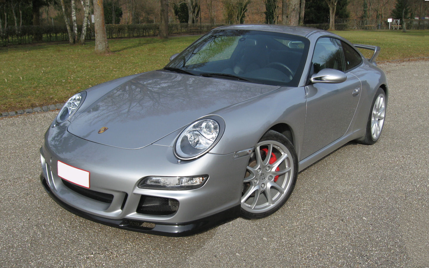

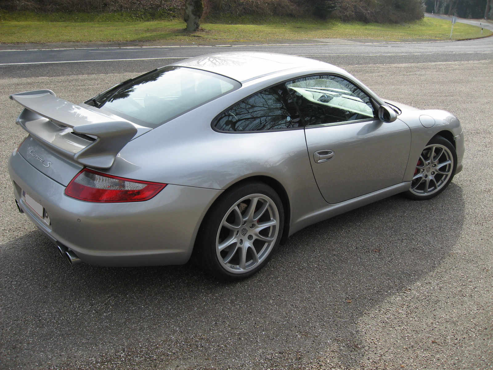

Hello,
I have Michelin pilot sport cup tires (235/19 and 305/19) for trackdays, and I have the opportunity to buy second hands GT3 rims.
I would like to know if it will fit my 997 Carrera S Aerokit Cup? Perhaps someone has already done this? :huh:
I'd appreciate if someone could give me advices before bying it.
If I compare some rims dimensions, GT3 front wheels will be 4mm more outside vs OEM and rear one will be 1mm more inside.
OEM wheels: 8J*19ET57 - 11J*19ET67
Sport wheels:8,5J*19ET55 - 11,5J*19ET67
GT3 wheels: 8,5J*19ET53 - 12J*19ET68
Another question: What is Pilot sport cup pressure that you put for trackdays with a 997 S?
Thank you for your comments and advices! :rolleyes:
Chris.
