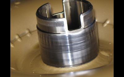

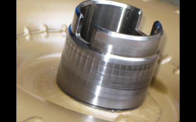

but this time is not as bad as the first time. Seems that the T/C is out of commision ( I had it remanufactuered May08, 8 months later damaged again ).
There was a whinning sound/noise coming I believe from the tranny, and from researching, if the whine/noise stops when car is not moving yet comes back when car is moving,
that means the T/C is damaged. and that is evident form the pix below.
The way I drive the car is 99.99% of the time on Manual Mode (the FUN mode :drive: I wonder, wait I think the M stands for Money sucking mode LOL), use it alot as a brake assist as well.
and that's what got me in trouble I think the first time, I used to downshift to 1st gear from I believe 30 or 35 MPH and that's really stops the car on it's track,
as most if not all tiptronic guys know. If you ask me now I'd say don't do it (not worth it unless you're going to hit something). I wonder how much stress that put on the engine and transmission!!!
So after fixing that car the first time I never did that on purpose and I was very careful, I may have shifted to 1st by accident a few times (not from 30 or 35 MPH to 0 MPH).

Q: Can these 2 faults be the cause of damaging the T/C, since they are pressure regulators?
would this somehow cutoff the supply of ATF from reaching the mating surfaces of the T/C to the Front Pump Bushing and made it so hot that the T/C got scored that bad.

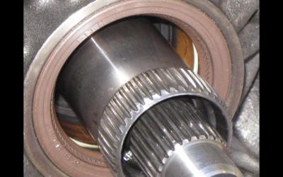

Front Pump housing (showing seal and bushing no apparent damage,but will replace anyway)

quick update
I left everything as is after disassembly for a long time till I figure out the cause of the problem, to no avail
until it hit me one day, the cause was right there in front of my eyes.
take a look at the pix below
after disassembly
Fluid level left in T/C after disassembly
afew hours later
leaving the T/C in the same spot same position after cleaning the fluid a couple times just to confirm, fluid comes back again.
the only logical conclusion is there is a leak in the weld after i had it remanufactured and made sense
since after I had the first problem and after assembly I noticed a film of oil all over the bottom of the tranny
but did not think much of it, and since it kept leaking obviously upto the point (6 months later) damaged the hub most likely
due to less fluid = more heat = hub expanding = touching (tight fit) the front pump bushing = scoring = more area for fluid to leak from easily
as noticable drops on the ground.
So I called the shop that rebuilt the T/C and will take it sometime this week to san jose to pressure test and rebuilt the T/C again
