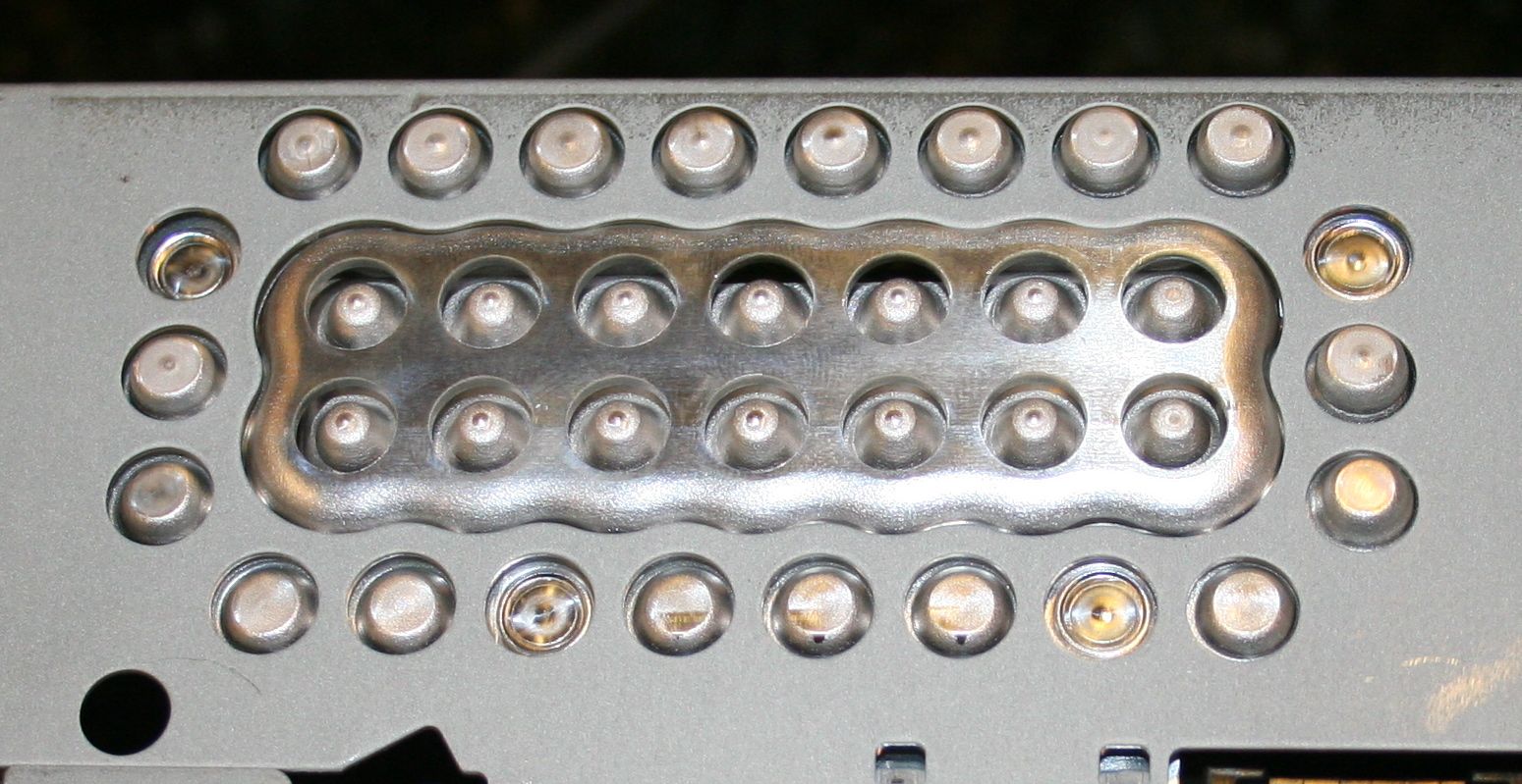

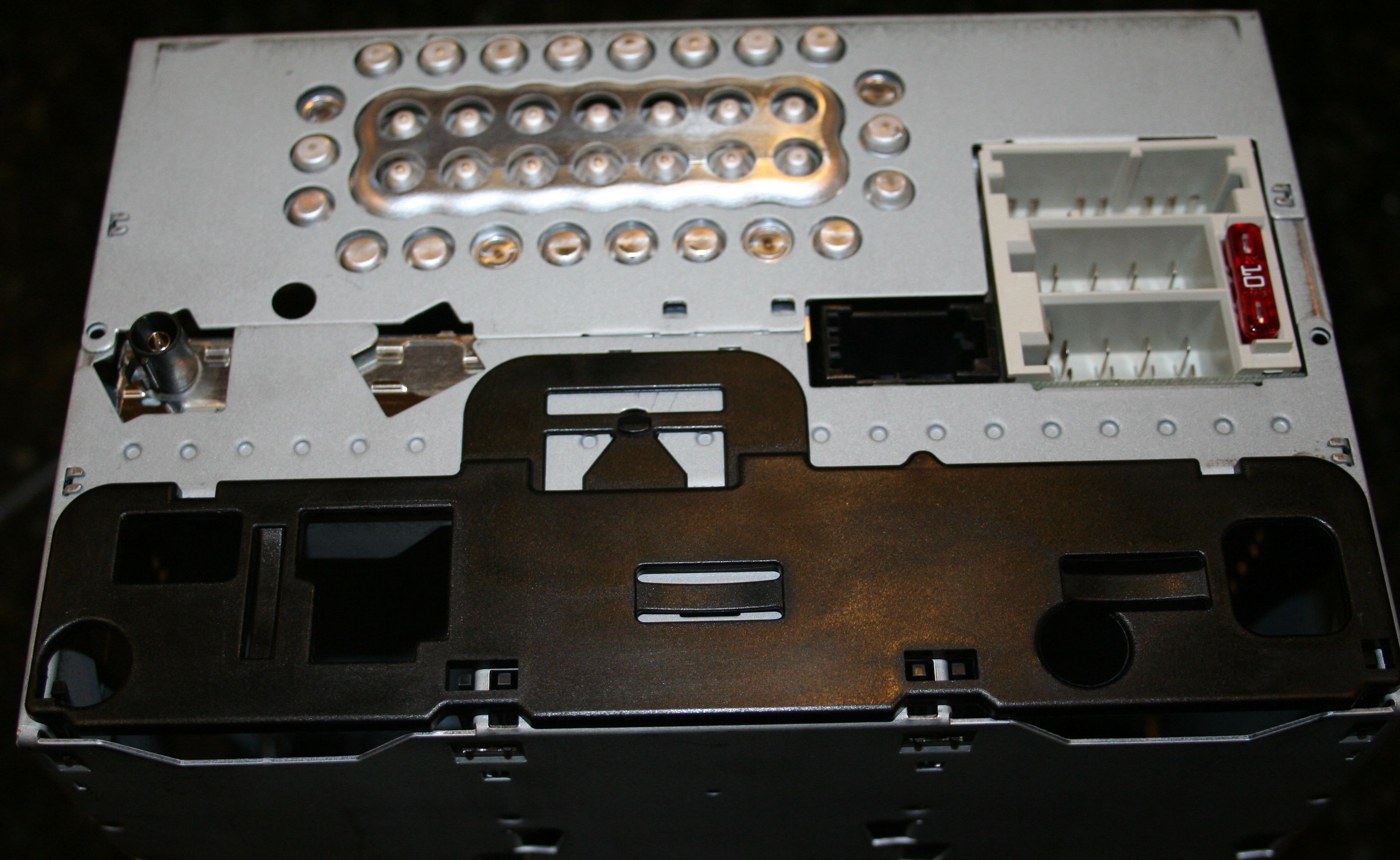

Pics below show back of my base CDR-24 aluminum dots are heat sink for small amp. My PCM does not have this.

To better understand your problem it would be useful if you could find the part number written on the unit.

I think even the non-Bose PCM uses an external amp - it's just not a Bose amp. I'm sure I read that somewhere.
It is still going to be a bit of work / wiring to make it functional.
Bose PCM head unit: 997-642-143-xx
non-Bose head unit: 997-642-141-xx
There are two types of PCM. Those for bose equipped cars and those without bose. The PCM units that are non bose will still work with the soundpack amplifier as it takes the signal from the speaker outputs. The BOSE equipped PCM s do not have the speaker outputs enabled , it uses the MOST link to send the signal to the BOSE amp to which the speakers are connected. Better to buy the correct PCM for your car than try and re engineer or reconfigure the unit.
