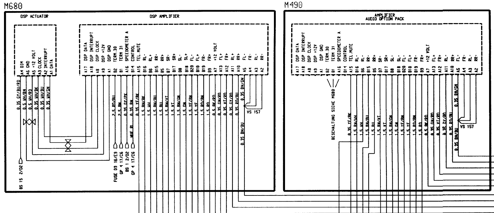

I've searched and am not sure if I'm missing it but I was wondering if you all can help me. I have a 2001 996 Turbo (non bose, non-nav and non-most). I'm installing a aftermarket radio and I want to bypass the stock amp (Harman AES). Does anyone have the diagram that shows which wires in and out of the amp are? Thanks in advance!

Just wanted to get some suggestions... do you all recommend trying to use the factory amp on an aftermarket HU or should I bypass the amp and run the amp off my Eclipse HU? Anyone have experience either way?
