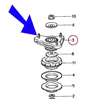

When my friend changed my shocks and springs, when every thing is done and while we putting it back to the car... he over tighten one of the 3 bolts and strip off the whole bolt... in the front right side of the car....
What should I call when I reorder this part with the parts department. or part number..... is it strut tower mount?... or something else...

For those of you following along at home.. this is what he is talking about. People strip these all the time.. and we replace them with a BOLT or knock out another stud from a used upper hat when we went to monoballs :)
