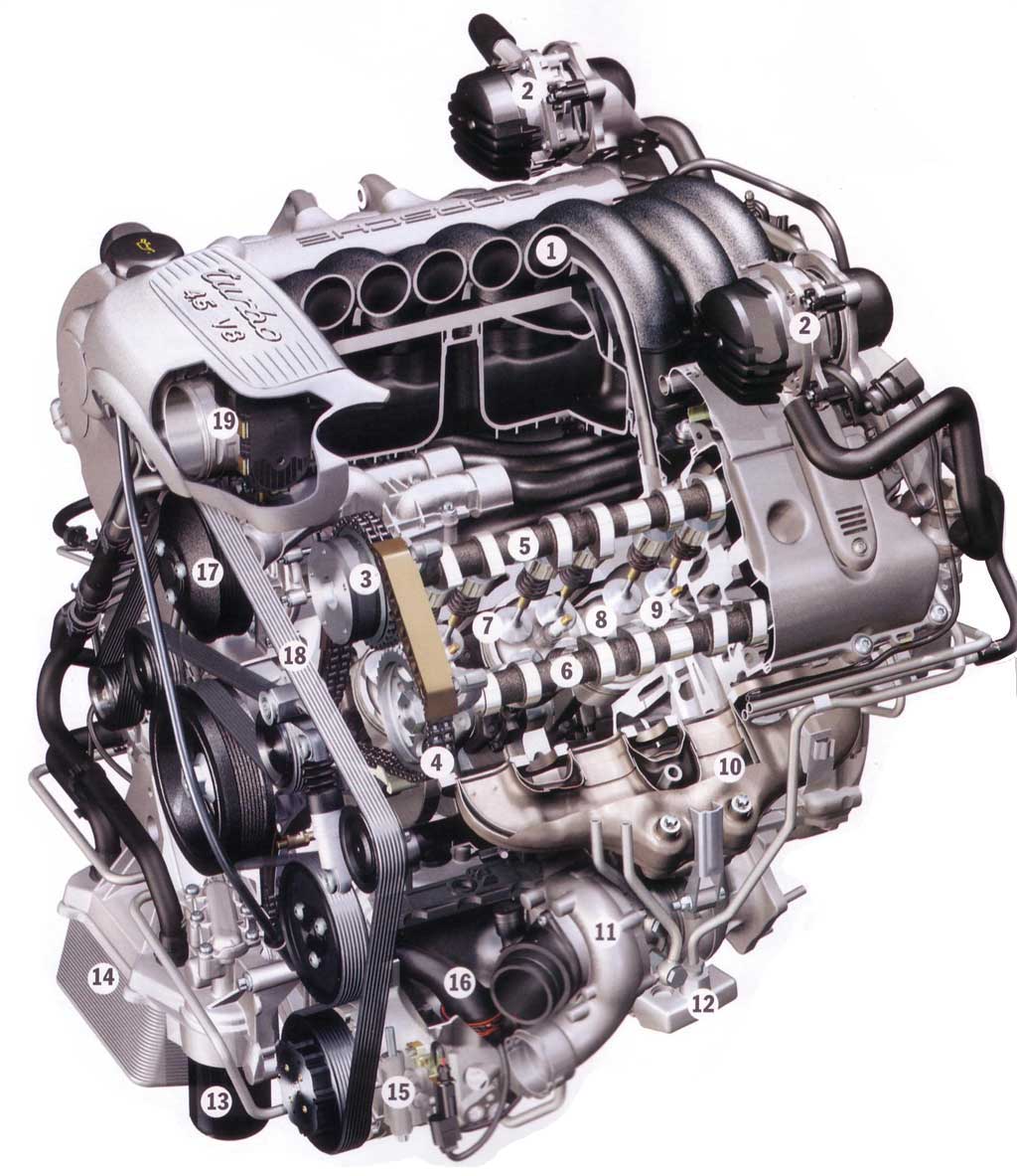

Here is a relatively good schematic (picture) to identify at least where the major components on your engine (not sure if you have a turbo).
1. Intake Manifold
2. Air-injection pumps
NOTE: Turbo Engine
3. VarioCam
4. Duplex timing chain
5. Intake camshaft
6. Exhaust camshaft
7. Valve
8. Piston
9. Spark plug
10. Exhaust manifold
11. Turbocharger
NOTE: Turbo Only
12. Oil collector on turbocharger
13. Oil filter
14. Oil/collant heat exchanger
15. Air-conditioning compressor
16. Oil pump pick-up pipe
17. Water pump (obscured)
18. Ancillary drive belt
19. Throttle-valve tract (electronic throttle
Credit for picture/information: www.panix.com/~clay/cayenne/cayenne-engine.jpg
Bill :beer:

Thanks for the engine photo!
