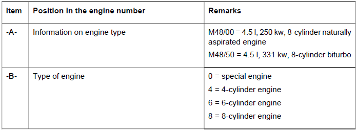

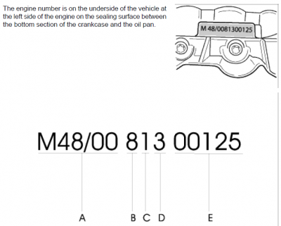

Hello all....I'm new to the board... I just arrived in Turkey and customs wants to see the engine block number. I guess to make sure I didn't steal the engine... Does anyone have a clue where it's stamped? I would rather not take the whole front end apart to find this... Thanks
