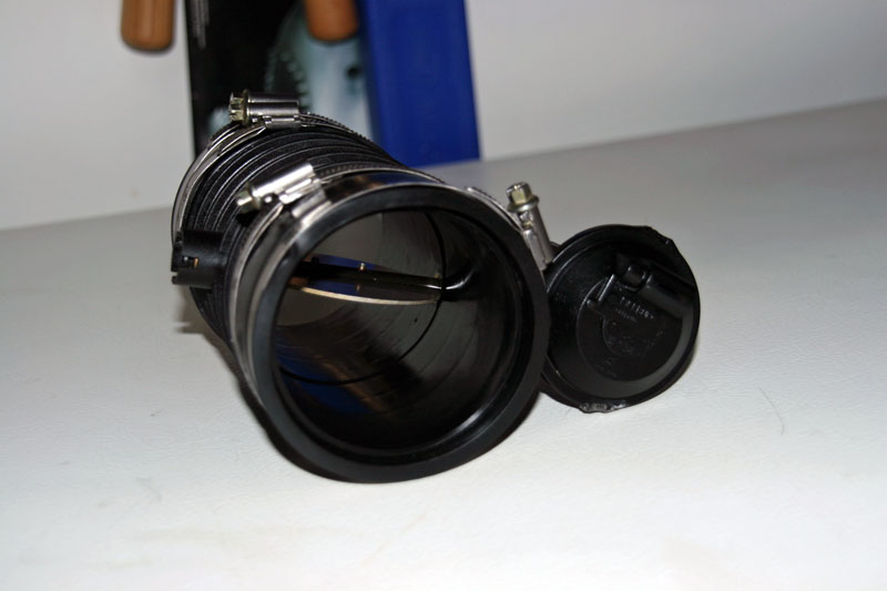

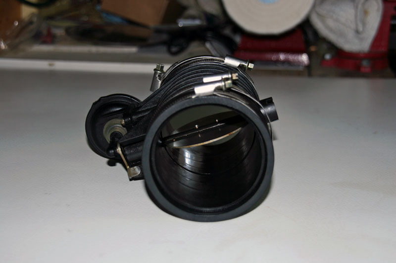

I think your vibration problem was caused by a not 100% effective resonance flap(s) in the intake manifold vertical pipe(s), before cleaning.
Now there is a possibility, I made sure that was clean and functioned fully, operating the linkage attached to ther vacuum canister. I assume you are talking about the (horizontal duct forward of the throttle body) this thing:
Silly for Porsche Service to not even try. My explanation is quite elaborate but it is because I spent hours making sure they understood all the conditions precedent to the vibration.
Thanks for the evaluation.
The ducts showed in your pics are indeed the resonance flaps.
At one time I had the engine compartment open revving slowly up to about 4,000rpm and this flap did operate at about 3,000, although there was no vibration. Could definitely hear something click and indeet you can see the stud on top rotate. There was a lot of oil when cleaning it but did not notice grit. But since I operated it about 5 times plus cleaned the linkage outside with a toothbrush this could be it.
So there is something else relatively simple for folks to try.
