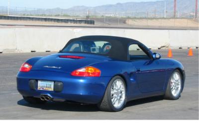

On the issue of left side vs. right side:
We also had this and ended up reducing an 18MM spacer to 16.5 to fit the 18" wheel and 285 tire just on the left side.
In addition both side fenders were rolled. Also, the car had H&R springs and maximum camber -- a really tight fit.
On the issue of offset:
We have 63MM offset wheels with 18MM spacer making it 45MM offset on the right side, and 63-16.5=46.5 on the left side.
IMHO each car can be slightly different by a millimeter or two and this can make a difference in tire rub when we are trying to get maximum tire size under the fender and not rub the damper or spring.
Take care and :cheers:
Ed
