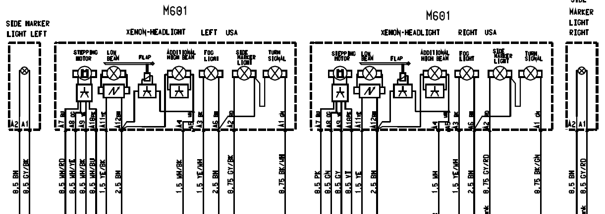

I have converted my car from a 996 TT into a 997TT. The headlights bolted in to the stock harness. So far I got everything to work except the High Beam?
Does anyone have the wire diagram of the headlights harness on the 996TT, and know where the high beam control is.
I would also need the wire diagram of the 997 Headlight so I can switch the high beam pins over.

Loren that image you posted is that the 996 wire harness pins or the back of the 997 headlight pins?
You asked for a diagram of the 996TT headlight pins - that is what I posted.
Loren,
Do you also happen to have the wire diagram of the 997TT headlight pins just like the 996 once you posted.. I need to find out which pins on the 997 head light are for the high beam so I can move the pins on my 996 over to make it work.
Hi can yo tell me if the wiring diagram you posted for the 996 tt is the same as in the carrera 2 pre fcelift? if not do you have it?

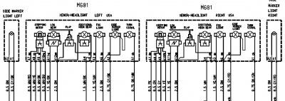

No, the early 996 and facelift 996 use different headlights.
Please do a search on the site for facelift conversions and headlights.
