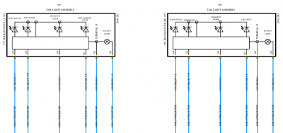

Well I am ready to get ready to try to plug in these led 997.2 tail lights into my 996

Could I get the pin layout for the 996 turbo tail lights and if you have the 997.2 led tails.

I already posted the 996TT diagram for you here.
And, the 997TT diagram.
Please make up your mind what you want/need.

Loren,
Yes thank you for the other diagrams. I actually need the tail lights ones.

997-2 tail lights
Loren,
I am so stumped. I was able to splice the 996 TT rear wire harness and connect it following your diagram to the new 997.2 led tails.
At first I was surpised it was so easy.
Everything worked
the turn signal
backup light
rear fog light
night light
brake signal
I was a happy camper. What I realized later is that when the night lights turns on it also turns on the rear turn signals at the same time. I have a feeling it has to be the led tail lights doing it, as they are only 6 wires coming from the wire harness into the led tail light. Not sure how to proceed at this point. I was thinking maybe inside the led module of the tail light there might be two grounds for the turn signal.
Do you know if there is a wiring diagram for the inside of the led tail light not just of the tail light assembly.

What I posted is what I have.
Realize on the newer cars the lights are all run by "control boxes".
