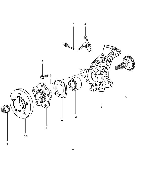

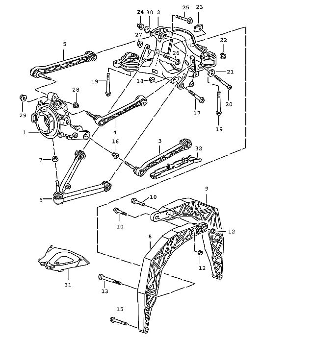

Well both cars are Porsche but are quite different. Brakes should be no problem on either car. The 993 has the beautiful multi link rear suspension that is a work of art. I think it was way ahead of its time but i guess do to costs they no longer use it. Anyway hope these pics help...First two pics are 996 front then rear. And the last two are 993 Front and Rear.
