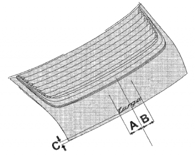

1. Find the middle of the lid.
2. Position the Targa logo with tile dimensions A and B = 98.4 mm and C = 29 ±1 mm on the rear lid and affix.
Yes, it is double sided tape.
