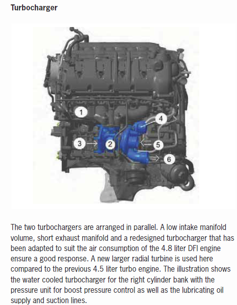

One other question, does the 2009 Turbo produce a higher horse power over the 2008? If so do you know by how much?
This is all they say (about the turbos) in the model year changes book.
