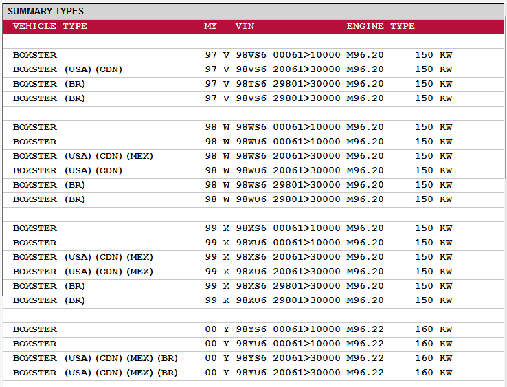

The VIN date code is X which I believe is 99.
RennTech's VIN decoder says it is a 1999.
The door name plate indicates a June 1998 manufacture date.
Do I have a '99?

Very interesting that your VIN says it is a MY99 and Porsche's database says MY98...
That's very odd. Plus, I just lost money.
Thanks for your help.
Edited by derb
I have a June 1999 build Carrera and it is a MY1999.
So, perhaps you just accidentally got a MY99 VIN assigned to a MY98 car - talk about being the last one off the production line for that (model) year.
There were almost no changes for MY98 to MY99 so very little differences.
I think the door sticker says a June '98 build. Must have been shipped over fast because the warranty began on July 20, 1998.

I called PCNA and they confirmed a build date of June 18, 1998 and the car is a '99. Guess the database says it is a '98 so the dealer can order the right parts for it. So now I need to start ordering parts for a '98 for my '99.
Based on my serial number my car appears to be the 731st off the line for the 99s. The warranty started on July 20, 1999. Isn't that kind of early for a new model year car to be sold (punched)? Could it have been a demo? That doesn't sound like a good thing other than the fact that any abuse would have brought out any issues with the engine. The engine serial number is also for a '98 so it's probably still the original engine. 95k miles- knock on wood.
