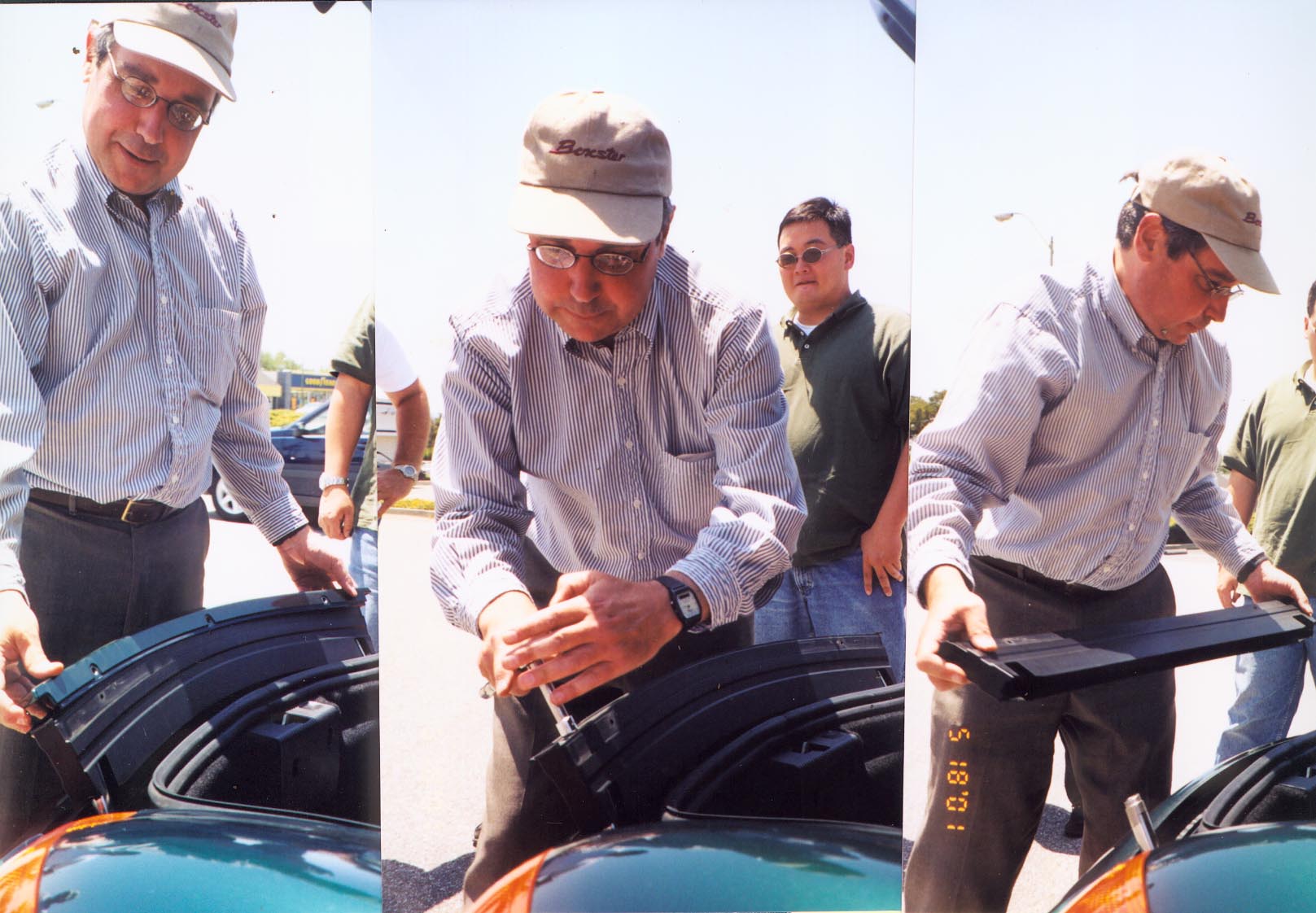

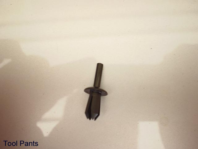

There are 3 black plastic rivets that have a pin in the middle. Push the pins out with a small straight punch or the end of a small drill bit and they will fall into the spoiler. Then you can lift the top off the spoiler. Then remove the 2 allen bolts that hold the metal body in place and the pins will inside it.
Once the metal body of the spoiler is removed you can get to the screws holding the top of the rear bumper cover in place.

Question : Are those three rivets re-useable ?? or should I order new ones first ?? assume available through dealers ?? If re-useable, can you describe re-installation ???
Thanks
The first time I removed a spoiler almost 6 years ago was also to put a sticker on. I reused the rivets. Just push the pins back in.
