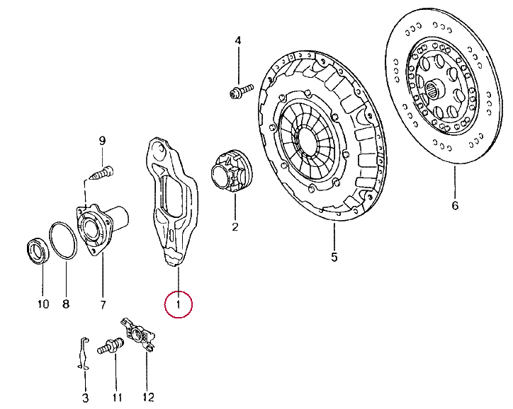

As Todd said...
Items 1, 2 and 5, (release lever, release bearing, and pressure plate are different for MY02 and newer cars).
Flywheel does not change for any 996.
