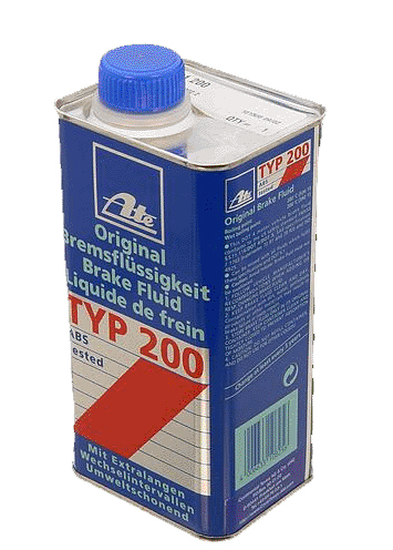

I checked online, and Tire Rack shows an all blue, one liter can marked "200". Other sites show the blue Ate 200 can with a big white square and red diagonal stripe. These other sites refer to it as racing fluid. Is there a difference in these Ate products with the slightly different labels, and are both approved by Porsche?
