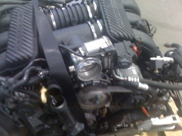

3.6 engine it's here. Nicelly packed by LA Dismantlers. Waiting for Brain, harness and the rest of the goodies.
Sorry, cannot attach the pic. Will post on my website latter and add link.
Sergiu

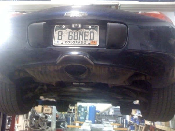

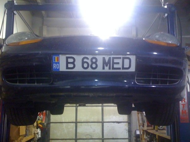

Still waiting for the DME/harness. The car it's up in the air getting ready to have the 2.7 engine extracted. I will figure out soon how to get the pics in here

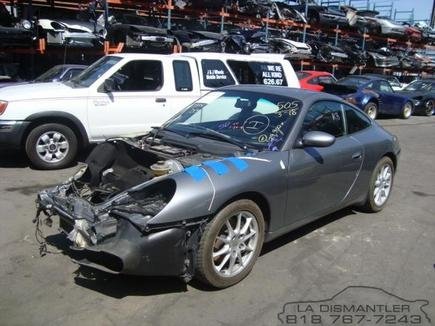

Sorry for the ignorance, but how do you tell the mileage anyway?
The carera that it came from (copyright LA dismantlers)

Finally up in the air ready to drop the 2.7
